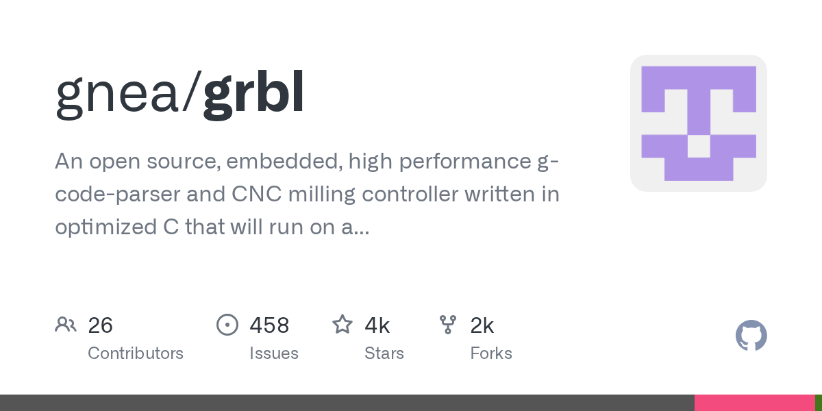

Я могу только на ощупь...ЗдесЯ не глядели?![]()
Спасибо, скачал , ознакомлюсь.![]()
GitHub - gnea/grbl: An open source, embedded, high performance g-code-parser and CNC milling controller written in optimized C that will run on a straight Arduino
An open source, embedded, high performance g-code-parser and CNC milling controller written in optimized C that will run on a straight Arduino - gnea/grblgithub.com
